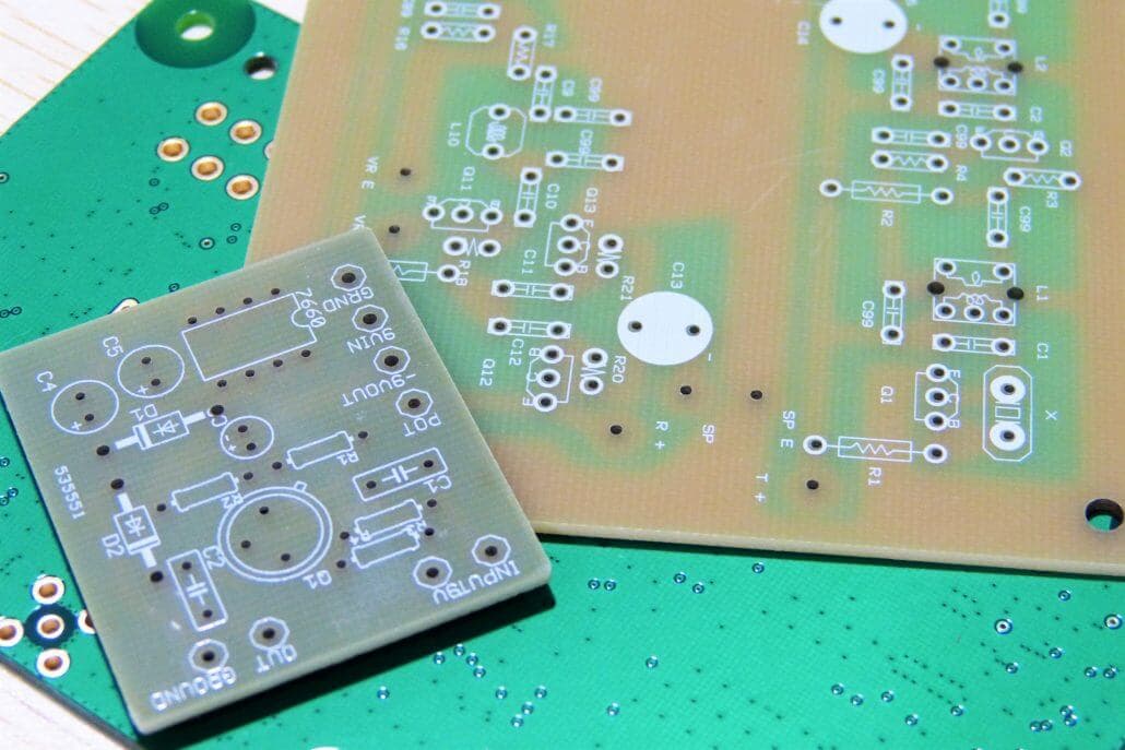

Classic single-sided through-hole boards on top of a multi-layer PCB

THT Single-Layer board
This is where things get a little complicated. Beginners
often forget that a through-hole single-layer board typically needs the
silkscreen on the other side of the solder pads.
GBL, GBS and GTO -> more common
or
GTL, GTS and GBO
The silkscreen typically contains information on the component
outline, polarity markers and designators/values. The side with the silkscreen
printing is the side where the body of the component lies. The leads are inserted
through the through-holes and soldered to the pads on the opposite side.

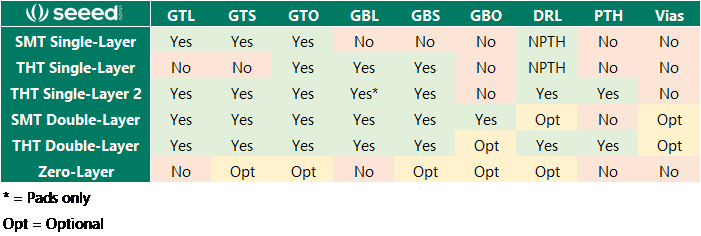

So that covers most of the oddly defined combinations. Within these, there are other possibilities, but we’ve listed the most common combinations in the table below.

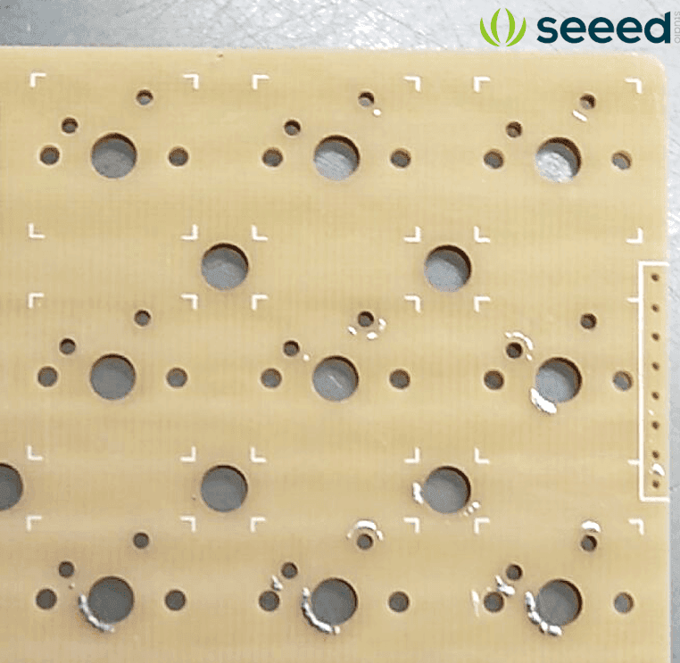

It may even involve more work. Double-layer boards are by far much more common than single-layer boards. So manufacturers keep big stocks of cores – FR4 substrate covered on both sides with copper. To make a single layer board, all the copper on one side has to be etched away.
If too much copper needs to be removed on a panel then the etching solution and etching time may not be sufficient to remove all the copper. In the image above, note the remnants of copper which have been plated with silver HASL surface finish left on the edge of some of the drill holes.
Despite that, single-layer boards typically don’t cost extra. In fact, at Seeed Fusion, we’ve even considered removing the single-layer option entirely – how many people specifically do NOT want pretty protective solder mask on both sides anyway? The reverse situation is more likely (single-layer boards, double-sided solder mask). Your thoughts? Let us know in the comments section and maybe we will actually do it.
