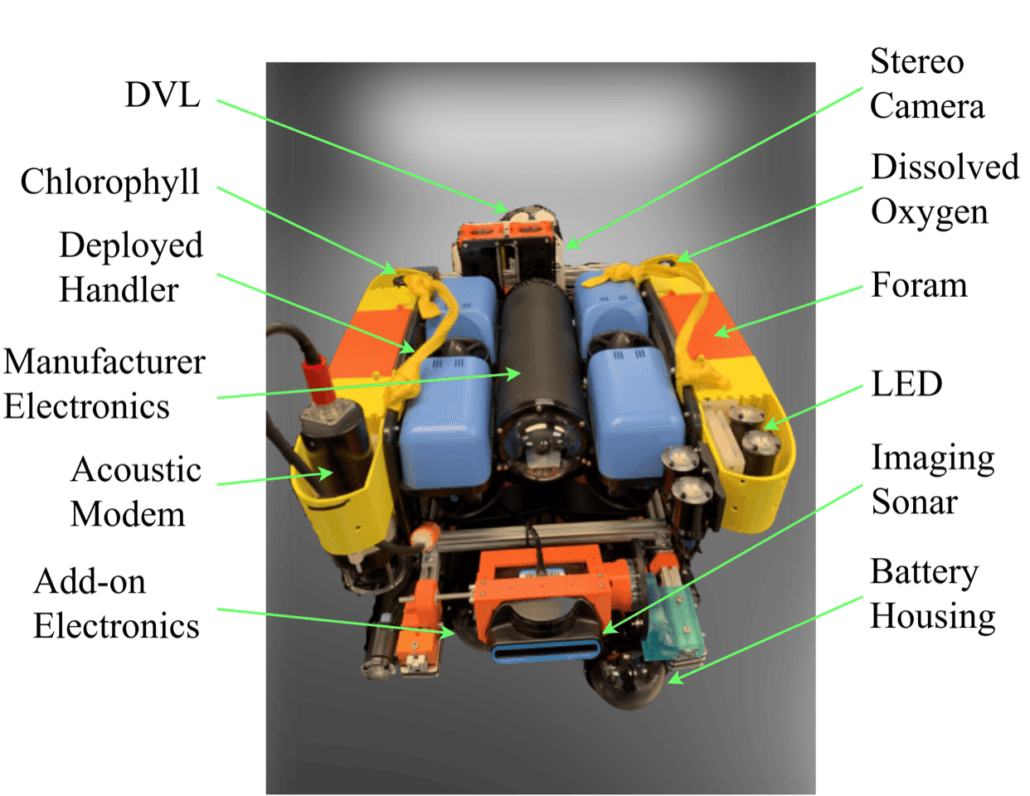

The under-ice ROV was developed based on the BlueROV-2 platform as a testbed because BlueROV comes with open-source control software and user interface software. Due to the lack of sensors on the base BlueROV model for good localization results, the project team integrated a suite of sensors to greatly improve the visual sensing and navigation of the vehicle. Professor Mingxi Zhou also shared with us the system integrated Seeed’s mini PC powered by NVIDIA Jetson NX Xavier to interface with all the add-on sensors using the Robotic Operating System (ROS) middleware. On the topside computer, there is the BlueROV user interface for remote control and a customized RViz interface for visualizing perceptual sensor measurements.
A photo of the upgraded ROV is shown in Figure 2. The under-ice ROV is developed based on the BlueROV- 2. The ground truth localization of the ROV was obtained using an Evologics 18/34 Acoustic modem on the vehicle side and a paired topside Ultra-short baseline (USBL) device. Meanwhile, an odometry fused from AHRS and DVL was available for the ROV pilot. To characterize the biochemical activities in the water column, a RBR dissolved oxygen optode and a Turner Design chlorophyll sensor were integrated.
Upgraded ROV
Fig. 2, Upgraded BlueROV for under-ice sensing.

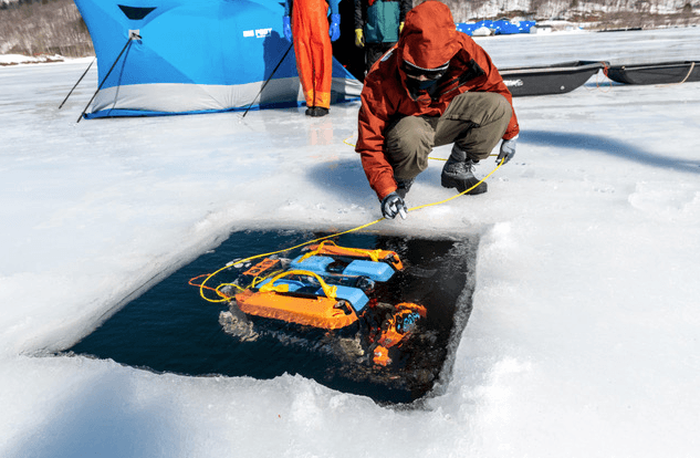

Field tests were conducted in March 2022 in Utqiagvik, Alaska on a flat landfast ice about several hundred meters off the coast. The ice thickness was about 1.5 meters. As shown in Fig. 3, ROV was lowered through a rectangle ice hole using straps with hooks at the end. The recovery was done by manually driving the ROV to the hole, then the straps will hook onto the ROV for lifting.
Field operation
Fig. 3. Field operation: Top-left panel shows the under-ice camera image; Bottom-left photo shows the ROV deployment; right panel depicts the ROV trajectory from the online odometry.

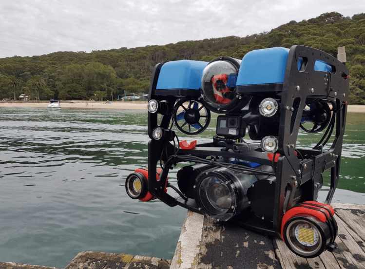

About BlueROV2
The BlueROV2 is the world’s most affordable high-performance ROV. With a 6-thruster vectored configuration, open-source electronics and software, and plenty of expandability, it’s the perfect ROV for inspections, research, and adventuring.
BlueROV2
Photo credit: Abyss Solutions, BlueRobotics

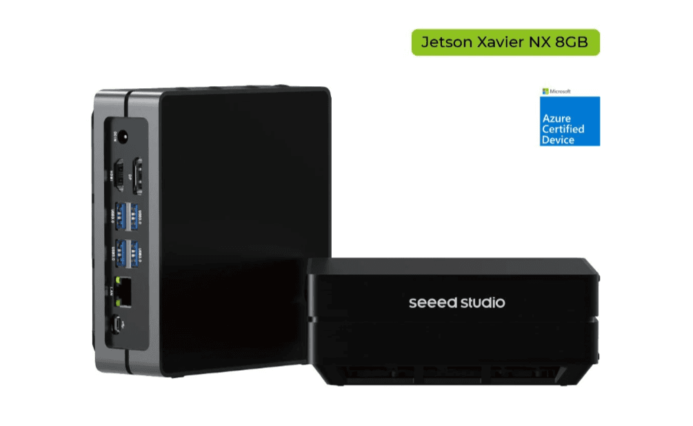

About Sub Mini PC
Jetson SUB Mini PC-Blue is based on the NVIDIA Jetson Xavier NX module, which delivers up to 21 TOPS, making it ideal for high-performance AI workloads in embedded and edge systems. The mini PC comes with the carrier board, heatsink preinstalled Jetpack, 128GB SSD, and enclosure. You can also check out our latest reComputer J20 built with 8GB/16GB Jetson Xavier NX module.
