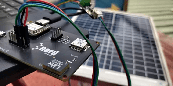

Solar energy is an excellent choice for alternative power because it is eco-friendly, affordable, and renewable. However, we need to use it smartly to optimize its benefits. LoRa-enabled systems can help us monitor and conserve our resources. Here is the field test picture and data dashboard.

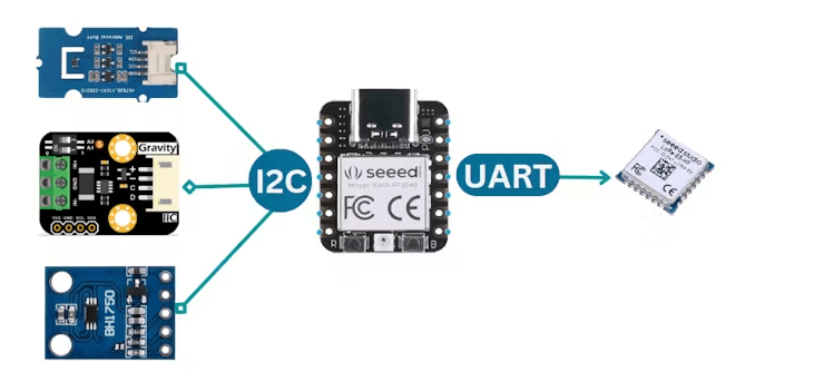

To monitor the solar PV cells, here pradeep uses a Gravity I2C Wattmeter sensor. Through this, we can monitor the generated voltage and consumed power and also the load current.  Also, we need to monitor the solar light intensity and the temperature to analyze the generated voltage vs solar environment status.  For this, Pradeep has used the BH1750 Light Intensity sensor and Grove Temperature and Humidity sensor.

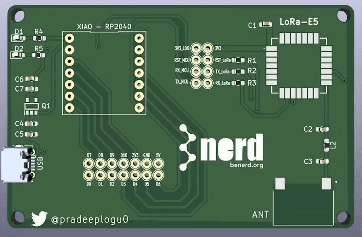

Now, we are ready with the sensing unit. Next, let’s design a system that can collect the sensor data and transfer it via LoRa. To design this system, Pradeep has used Seeed Studio Fusion PCB Assembly service.

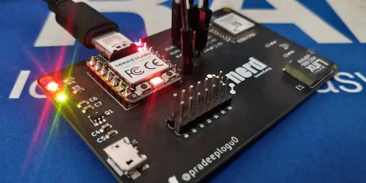

Moreover, we can connect all those sensors with Xiao RP2040 and transfer them via Wio-E5 Module. That’s all about the sender node. Next, we have to build a receiver to receive the data from our sender node and then publish it to the cloud. Here Pradeep also going to use the same PCB design with Blues Note Card and Notecarriers. Xiao + Wio-E5 PCB will receive the data from the sender, and it will transfer the data via Blues Cellular Notecard. Finally, we can use Qubitro and Qubitro API to share and visualize our solar PV data.
Hardware Connection:

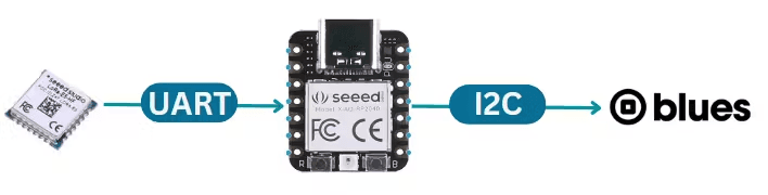

On the transmitter side connect all three sensors with the XIAO RP2040 by using the I2C port. And the Wio-E5 is already connected to the Xiao RP2040 by using the UART port.

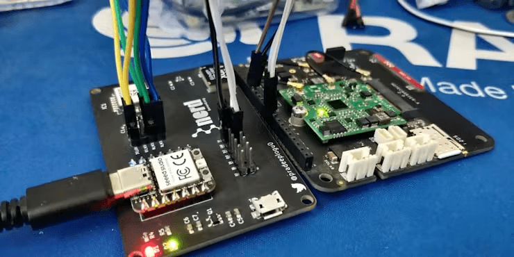

On the receiver side connect the Blues Wireless notecard with the XIAO RP2040 using the I2C port. And the Wio E5 is already connected by using the UART port. The receiver node will receive the data via LoRa and transfer the data to the cloud by using the Blues Notecard.

The PCBA service was amazing, I would give it 6 out of 5. The PCB quality and the assembly were flawless. Seeed Fusion has a lot of components in its open library. The ordering process was very simple. Just upload the Gerber and choose the quantity of the PCBs, that’s it. I got all my fabrication status from customer service, so it was really a pleasure to work with Seeed.”
