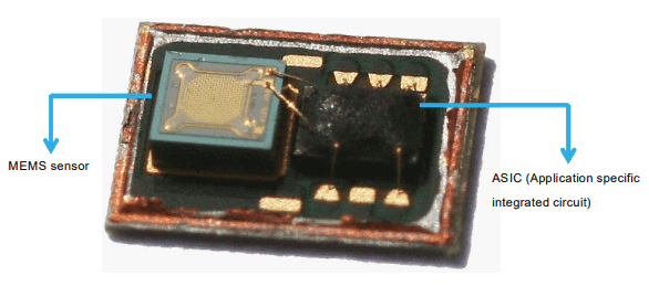

MEMS microphones, also known as a microphone chip, is a miniature SMT acoustic device that picks up sound waves. It typically consists of two parts situated side by side; the ASIC chip and the MEMS acoustic sensor mounted on a PCB board, which is then enclosed within a metal or plastic casing. Sound waves must enter the enclosure to reach the acoustic sensor somehow, so inevitably a physical hole is needed somewhere on the package. This hole or sound port can be located on the top of the package on the enclosure, or on the bottom. If it is located on the bottom, a hole needs to be drilled into the main PCB board as well.
Bottom-port MEMS sensor with the casing removed. The rigid plate of the MEMS sensor can be seen on the left.

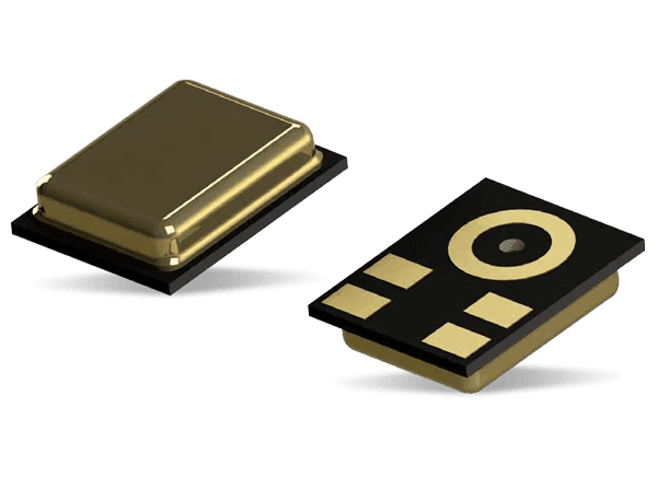

Bottom-port MEMS microphones such as the MP23ABS1 by ST have the inlet located directly below the acoustic sensor which maximizes the size of the back chamber. A larger volume in the back chamber allows the membrane to move more freely and therefore increases the signal to noise ratio (SNR) and improves low-frequency response. Likewise, a smaller front chamber improves high-frequency response by removing the Helmholtz resonance to a higher frequency. This configuration provides optimal performance but comes with a downside.
Top and bottom sides of the MP23ABS1 MEMS microphone by ST
For these types of microphones, the hole is located on the same side as the solder pads, so care has be taken to prevent solder or flux leaking into the opening during soldering. Therefore, it goes without saying that wave soldering is not recommended.
With a typical reflow soldering procedure using an appropriately designed stencil, solder should not find its way into the inlet. Bottom-port MEMS mics can be identified by the characteristic ring-shaped ground pad encircling the sound port. The corresponding opening in the stencil should be designed as follows:

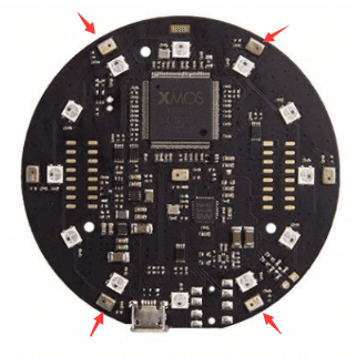

Seeed’s ReSpeaker Mic Array v1.0 has seven top-port MP34DT01-M microphones; one in the center and seven spaced equidistantly around the edge of a circular board. The ReSpeaker mic array was designed to be able to locate the position of the source, so the six outer mic units are spaced as far away from each other as possible. However, this meant they were situated in particularly precarious positions.
In early production runs, an unusually high proportion (around 10%) of mics in the four corner positions completely failed or had poor performance. Post reflow part substitution isolated the problem to the mics and since the failures were almost always located in these four areas, suspicion was directed to the design of the panel.
Location of the four defective mics

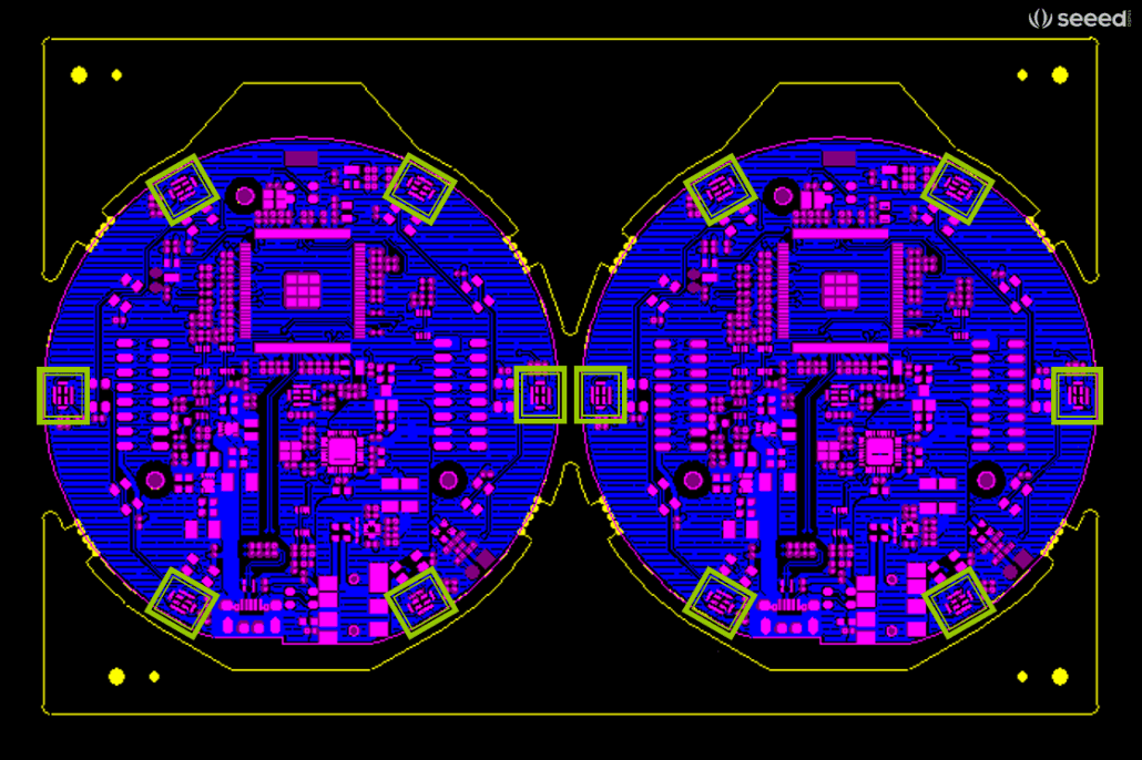

5mm away from each of these four mics were the four tabs that held the board in the panel. To free the board, a bending action is applied to break the tabs. Seeed’s engineers speculated that, despite having stamp holes lining the board edge and sufficient component to board edge spacing, the force may have been enough to damage the delicate mics.

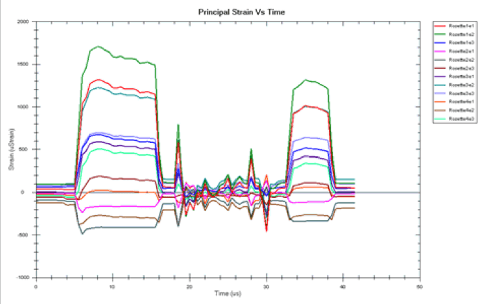

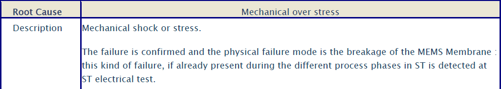

Samples of the defective mics were returned to the supplier for professional analysis and the findings confirmed that the inner membranes of the mics were damaged by mechanical stress. Strain gauge analysis verified that the depaneling stage was indeed the most probable point of failure and the cause of the membranes’ rupture.
Component Damage Report
To resolve the issue, the panel was re-designed to simply move the tabs so that they were located in the middle of two mics, at least 15mm away from the tab, and the width of the tab was reduced. This effectively eliminated failures and increased the yield considerably.
Relocating and reducing the width of the tabs did the trick. Mics highlighted in green.
