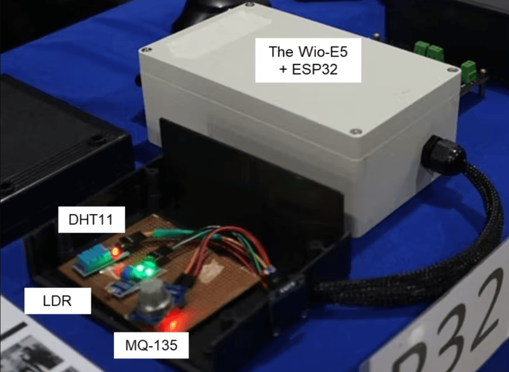

The Entire LoRa® Sensor Node
This DIY LoRa® sensor node serves as the LoRa® sender. The White Box contains The Wio-E5 + ESP32 Development Board: Grove Wio-E5 and Hibiscus Sense (ESP32), while the Black Box contains 3 types of sensors:
  • MQ-135 Air Quality Sensor
  • DHT11 Sensor
  • LDR Module Sensor

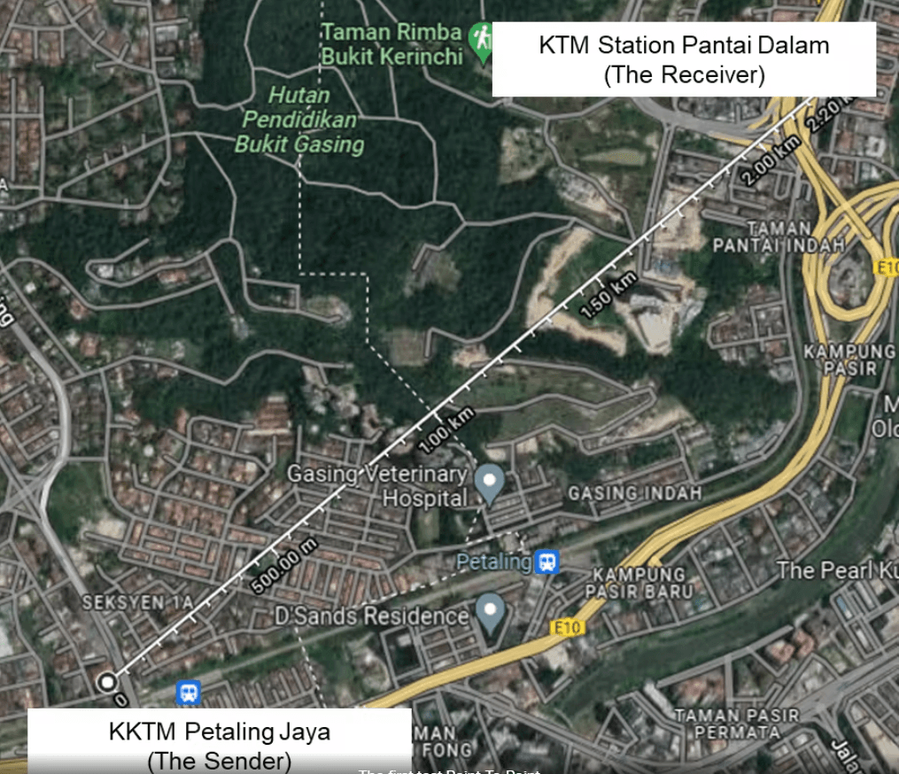

The First Test of Point-to-Point Network
The initial test is carried out between the LoRa® sender and receiver. The receiver is connected to the internet via the cellphone’s cellular network. It may receive data from the sender while the LoRa® communication is active. The field test indicated that the pair connection can go up to 2.20 kilometers, which is noteworthy considering the test site is in the suburbs.

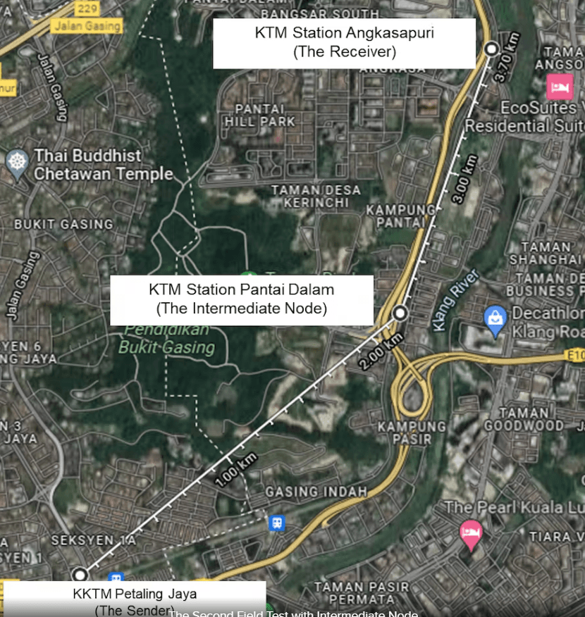

The Second Test with the Intermediate Node
Nextly, another LoRa® development board which is the Wio-E5 Parallel MCU Development Board was added to act as the intermediate node or the middleman between the LoRa® sender and the receiver. Previously, one could only obtain signals within 2.20 kilometers; today, with the intermediate node, the range gets up to 3.7 kilometers.

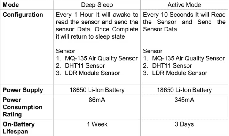

Aiman used a multimeter to measure the currents of the Board and the sensor to determine power usage. Here is the result of the one-hour measurement. The battery used is a 18650 Li-Ion battery with a capacity of 2000mAh.
Deep Sleep vs Active Mode

Following field testing, both recommended methods extended the LoRa® communication range while decreasing the power consumption of the LoRa® sensor node. The previous P2P transmission range is just 2.2 kilometers, however, with an Intermediate Node, the range may be increased to 3.7 kilometers. When compared to the normal setup, the LoRa® sensor node with battery power may survive 2.45 times longer with the Deep Sleep configuration.
