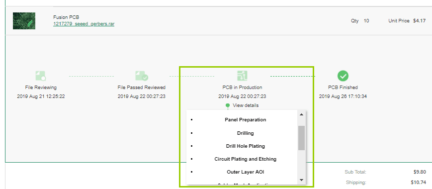

It’s been on our to-do list for a long time and you’ve
constantly been nagging at us to get it done – now it’s finally online! We’ve
upgraded the PCB and PCB assembly order production statuses so you can have a
better idea of how your order is coming along. Worried your order has gotten
stuck? Taking a little longer than usual? Just log into your account, go to
your Order History and click for more details.
*Please note that not all PCB orders (notably Premium and
Advanced orders), will have detailed production statuses, but that does not
mean they are not being processed! If in doubt, ask our support team.

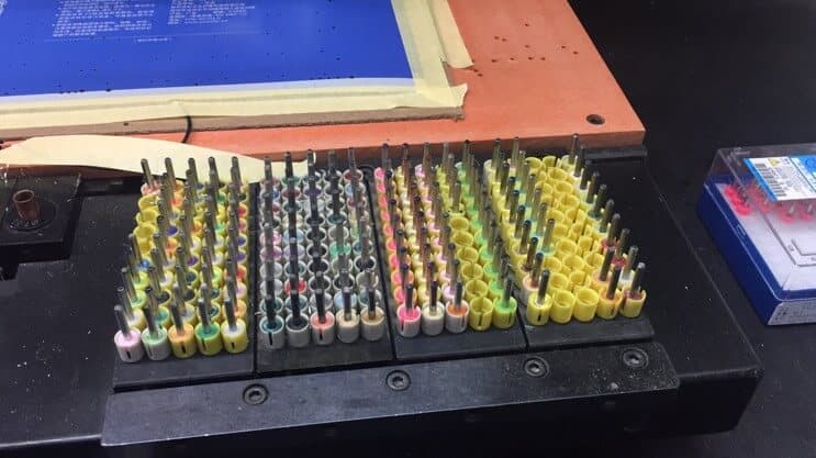

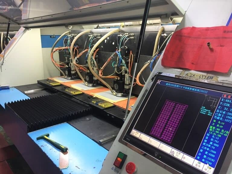

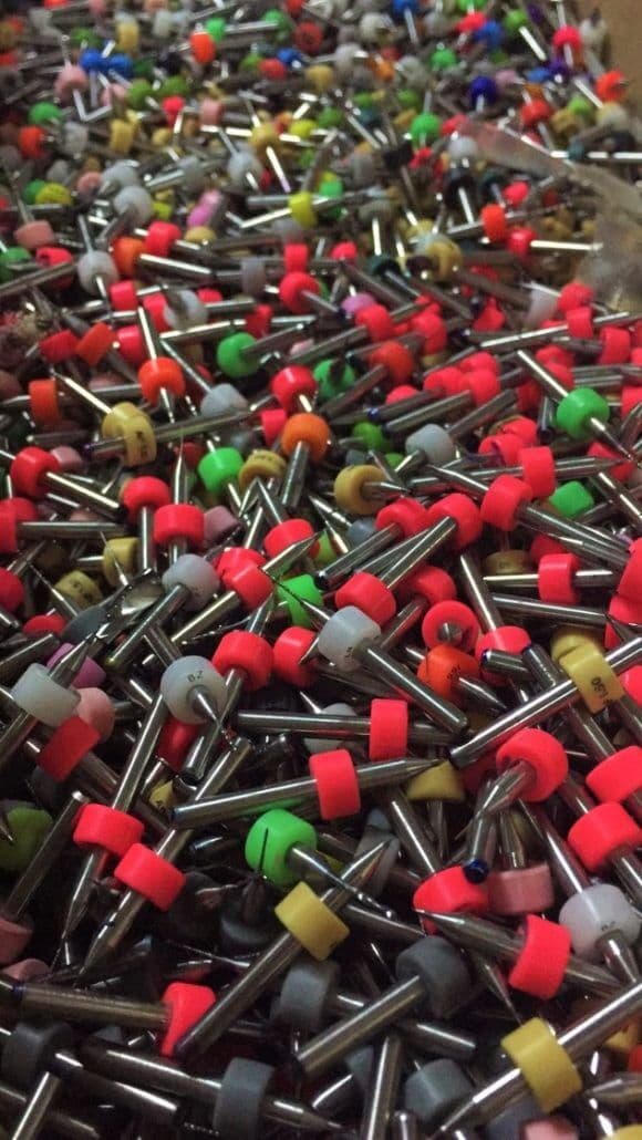

Drilling
All the standard drill holes, including plated, non-plated
holes and milling slots are drilled at this stage. The noisy thundering drill
machines automatically change drill bits and sense if a bit needs replacing. At
this stage, the freshly drilled holes do not have any copper plating.

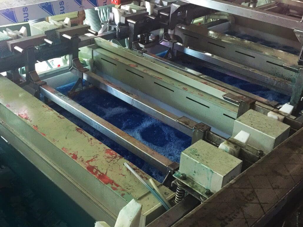

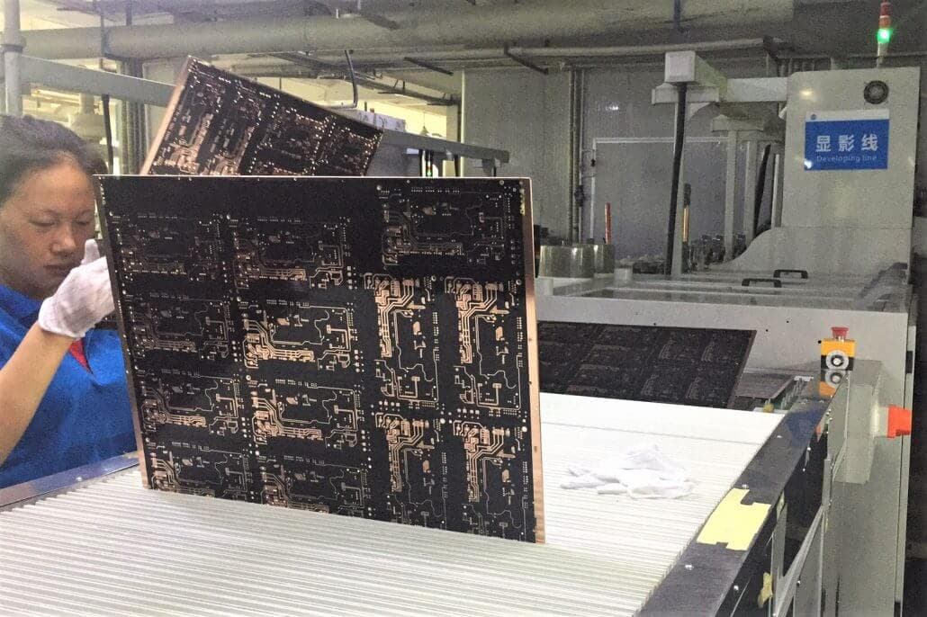

Drill Hole Plating
The first plating stage. The entire panel is hung on rails
and dipped into copper sulfate baths to build the initial layer of copper on
the walls of the holes. The thickness is only a fraction of the final copper
thickness at this point.

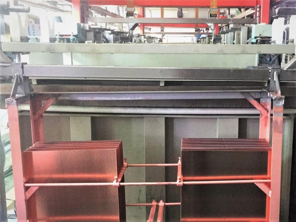

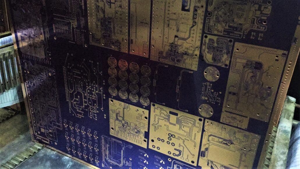

Circuit Plating and Etching
Several bathing, developing and etching steps are taken to build-up
on the thickness of the copper features and remove or etch away the unwanted
copper. Here the final desired copper thickness is achieved.

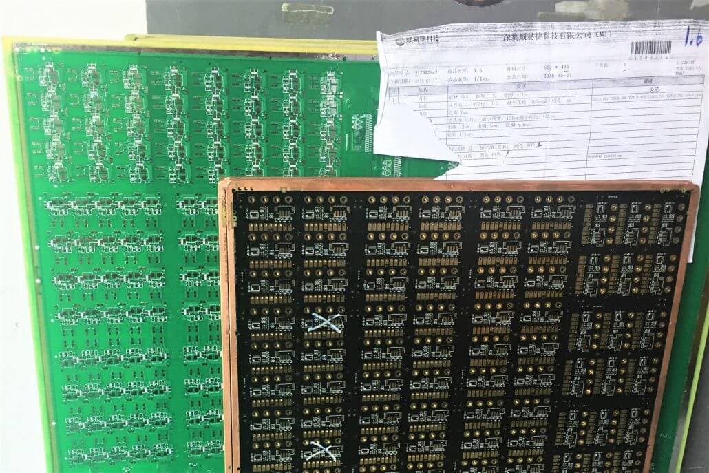

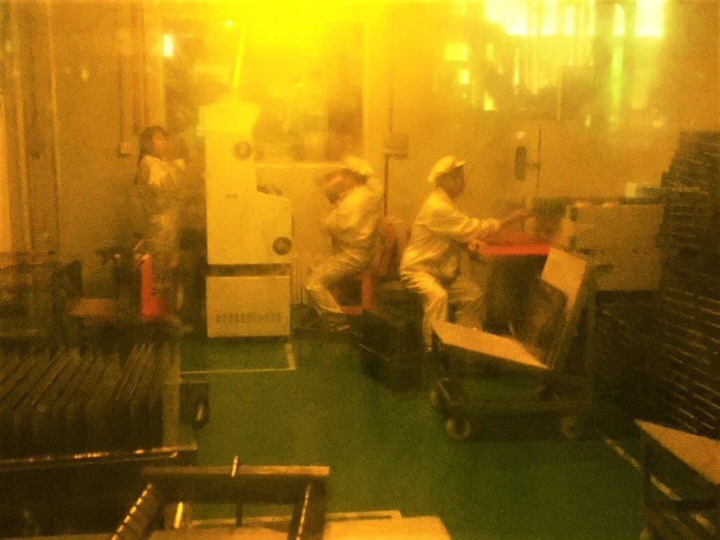

Solder Mask Application
Solder mask (the main colored coating of the PCB) is applied
using silkscreen equipment. The boards are then baked to cure the solder mask.

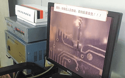

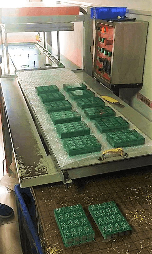

Board Routing
Time to free the boards from their panels. High-speed
routing machines cleanly mill out the pieces, and boards requiring v-cuts are
loaded into the v-cut machine. Boards with a lot of milling or many v-cuts can take
longer to process.

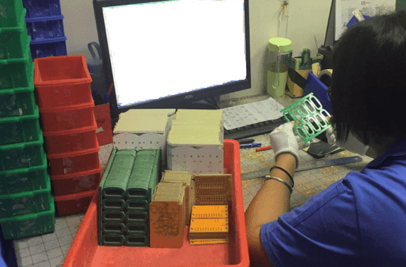

Quality Checking
The boards are cleaned and meticulously inspected for
defects such as board warpage, blisters, solder mask ripple, exposed copper
edges, faded printing. After discarding defective pieces, the technicians count
if there are a sufficient number of acceptable pieces left. If not, then they
may need to produce another batch from scratch ☹.
