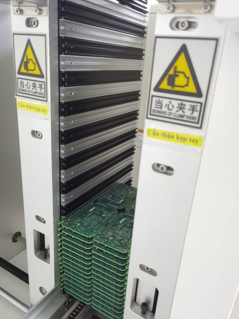

The first step in SMT manufacturing is to prepare the PCB. A PCB loader is used at the start of the production line for loading PCB to the line, which is to provide a fixed position for the next phase of the process.

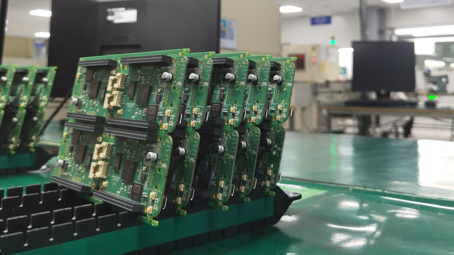

The next step is to reflow the PCB. Reflow is the process of heating the solder paste to melt it and create a permanent bond between the components and the pads. The PCB is placed in an oven, and the temperature is carefully controlled to ensure that the solder paste melts and re-solidifies correctly. This process creates a reliable and robust connection between the components and the PCB. Although it may seem like a simple part of the process, the correct reflow profile is crucial to guarantee satisfactory solder joints and prevent damage to the components.

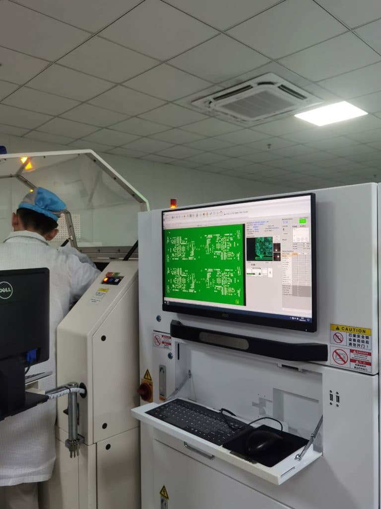

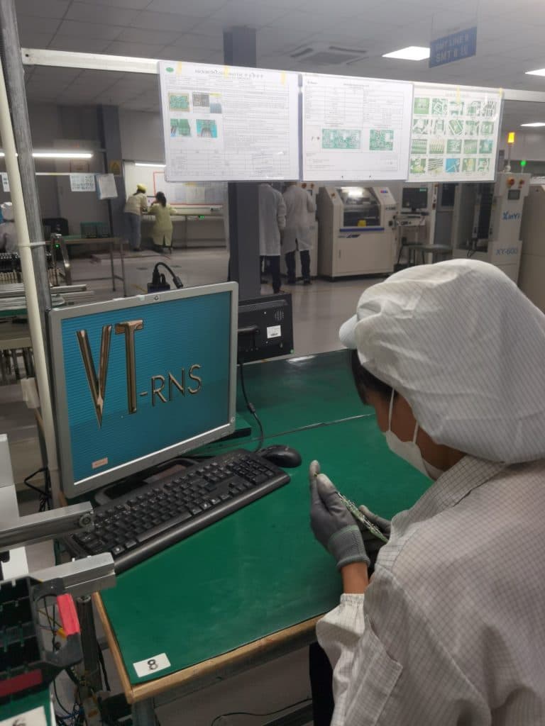

After soldering, the board is subjected to cleaning and quality inspection to identify any defects. Automated Optical Inspection, also know as AOI, is a process used in manufacturing to inspect products or components using high-resolution cameras and software programs. It can identify issues such as missing components, incorrect component placement, or soldering defects.

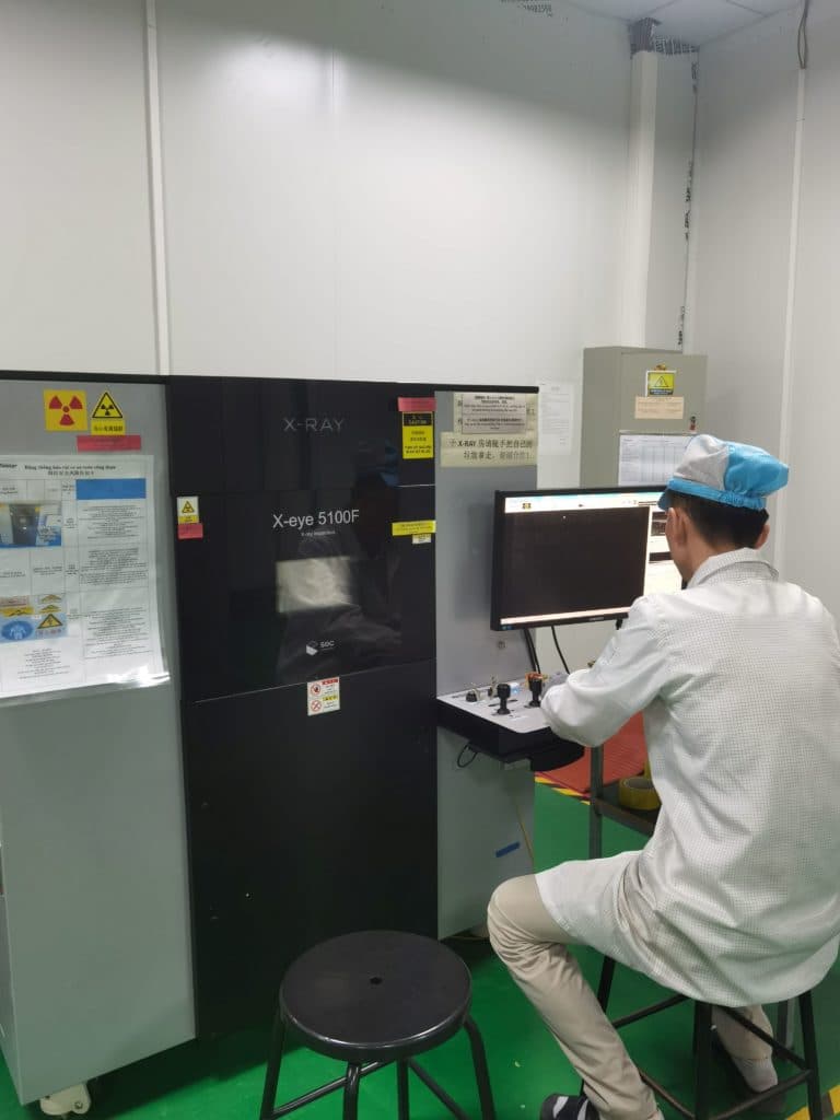

X-ray inspection is to penetrate non-metallic substances in objects through X-rays without damaging the object being inspected. This technique is used to detect faults such as the quality of BGA component soldering and whether there are any short circuits present. While AOI uses high-resolution cameras to detect faults in products or components’ external surface, X-ray inspection penetrate products or components’ internal structures, such as detecting short circuits, missing solder, and other defects in products like lithiumion batteries and IC chips.
Both of the inspection processes are critical, especially for high-volume production, as it allows for quick detection and correction of any manufacturing defects.

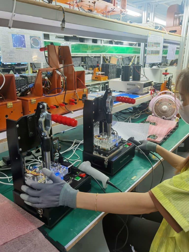

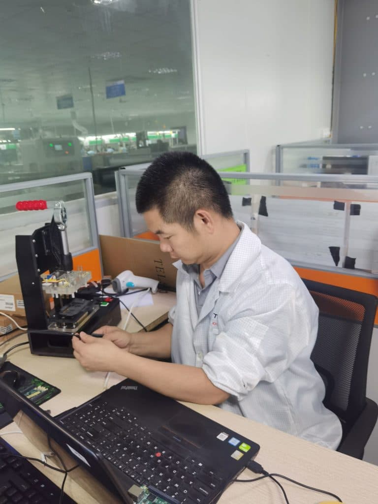

We are almost there! Now you can see the semi-finished BeagleBone Green. The final stage is functional testing. These tests examine the complete assembly instead of individual components, guaranteeing that the products will operate appropriately. They act as the final stage between manufacturing and the market, ensuring the product is of high quality, reliable, and ready for distribution.

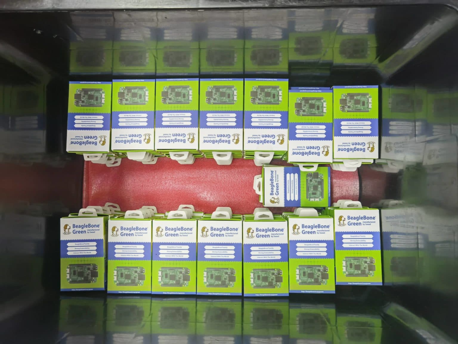

We are very pleased to see our BeagleBone Green manufactured in Vietnam, and are satisfied with the overall quality of it. With the help of experienced workforce and advanced equipment, our product can meet the necessary standards for reliability and functionality. We are delighted to begin our “Made with Vietnam” journey through this collaboration, and expect to see exciting developments in the future of a decentralized, open manufacturing.
