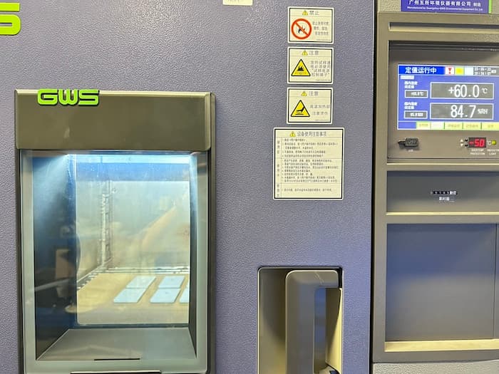

We placed over 150 trackers into a specialized temperature test chamber, ready to endure the extremes. The devices were divided into two batches: one batch remained off, while the other actively transmitted data, set to different modes, such as transmitting data every 5 minutes or 30 minutes.
Trackers inside the temperature test chamber

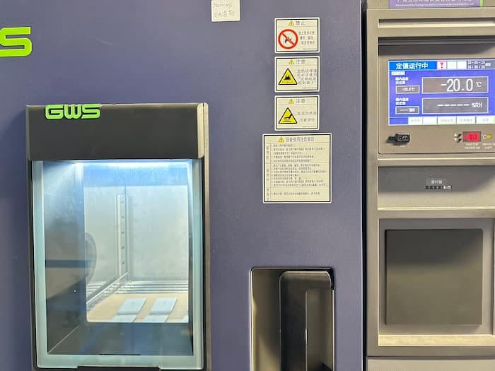

In the first part, both batches of devices endured a frigid -20°C environment for 48 hours. Then, the temperature was raised to a scorching 60°C for another 48 hours. Throughout this 96-hour ordeal, we diligently monitored the active devices to ensure they functioned normally.

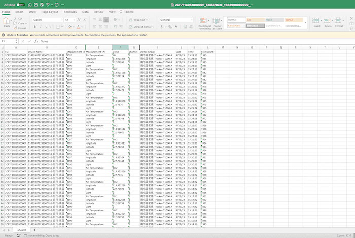

Each device in the test had a corresponding Excel sheet where the results were meticulously recorded. The test results for device 2CF7F1C05180000F is given below.
Test results in excel sheets

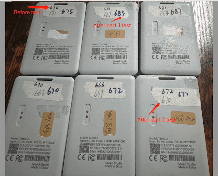

Following this extreme temperature cycling, all devices were retrieved for testing. Devices that were initially off were powered up to check for any startup issues, and a comprehensive functionality test was conducted on all devices. Additionally, we conducted a physical examination to check for any deformations, comparing the thickness of each device before and after the test.
Thickness before and after the tests

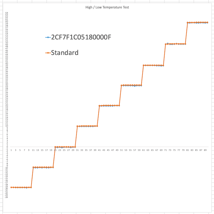

This phase included the same tests as part one, with a unique focus on verifying the accuracy of the internal temperature sensor readings. T1000 records the temperature multiple times at each interval, and the results showed a discrepancy within an acceptable range, a reassuring sign of the device’s precision. To visually demonstrate these results, we’ve included a photo below:
Test results in graphs

Test image for 60 degree Celsius
Test image for -20 degree Celsius
