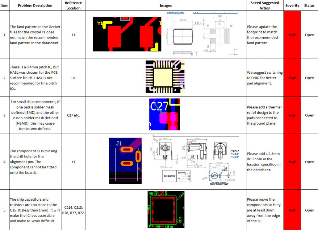

Example of what is checked in Seeed Fusion DFA and DFM reviews

As every
PCB designer knows, one small mistake could ruin your boards and the
possibility of pulling off a meaningful run. Getting everything perfect first-time
round is what everyone wants but in reality, with so many different parts, from
different manufacturers, with varying degrees of reliability coming sit on your
one PCB board – it rarely happens. It’s easy to forget the complexity and
margin for error involved in making a single working device that something as essential
as a footprint check is often overlooked or not done properly. A DFA check done
by a qualified practicing engineer can be just the thing required.
Seeed Fusion offers Design for Assembly review for all PCB assembly orders to remove nasty surprises when most necessary. Performed by our own experienced engineers with ample hands-on product development experience, there’s no one better to give you peace of mind. While optional, choosing to have the review done or not can make or break your project.
