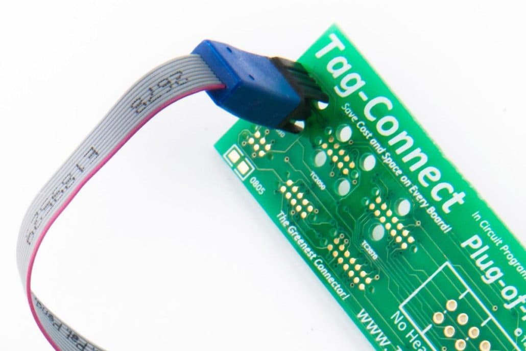

If you take a look at the guts of any sufficiently sophisticated product, you might find a programming header or a vacant spot on the PCB where a programming header might go.
This header is typically used to program a microcontroller when it is already installed on the PCB, hence the term “in-system.”
In a mass production scenario, it does not make sense to install this header. It is there for the designer for debug purposes and is not installed during production to eliminate the cost.
There are many ways to accomplish this in-system connection and one of my favorites is using the Tag-Connect system. This eliminates the need for extra components on the board. I have a few of these special cables laying around which I can use to connect to all my boards because I use the same Tag-Connect footprint on all my designs.

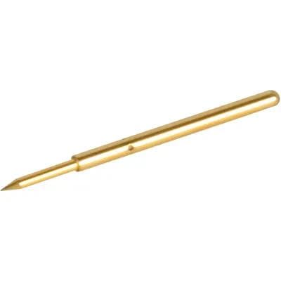

A popular way of testing a design is to clamp it down against some spring loaded, conductive pins that connect your boards test points to the text fixture control electronics. A fixture should mechanically align your board to these pins for max repeatability.

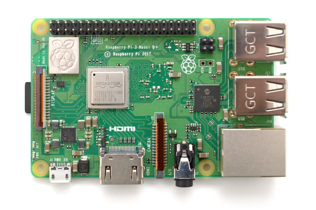

Your test fixture needs a brain and computers are cheap, small, and are more than enough to operate your text fixture. Most all test fixtures will need to run from a computer which will execute your test program.
A Raspberry Pi is an excellent choice for your test fixture computer. It is a compact computer that has an easy way to interface with peripheral devices via the header with all the GPIO, power, and communication available.
The most popular operating system for the Raspberry Pi is Linux and if it’s good enough for Mars, it is more than enough for your test fixture.
The Raspberry Pi will pair nicely with an interface board that extends the capabilities of the Raspberry Pi to run specific test on your unit under test (UUT). Just like raspberry pie and whipped cream.
Supplying your own computer eliminates any compatibility issues that your manufacturer’s unknown computer might have. There is no guess work because you set up the computer exactly how you want, they just have to plug it in.
